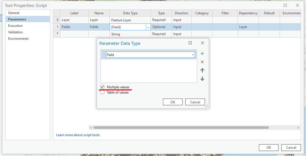

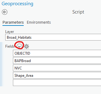

Sounds like you want to create a parameter that has a dependency to a layer parameter and that it takes multiple values. This is easy to set up. The basics are shown below.
This will give the user experience of allowing you to select multiple fields:
