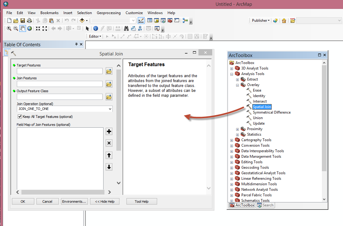

Yes it is possible with ArcGIS.
Using ArcGIS Desktop you could:
1. create point features from your address data.
Geocoding a table of addresses in ArcMap—Help | ArcGIS for Desktop
2. use a spatial join to pass desired polygon data attributes to the point data created from your address data.
Spatial Join—Help | ArcGIS for Desktop
Mark
