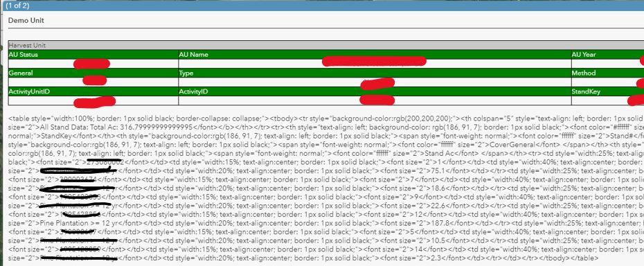

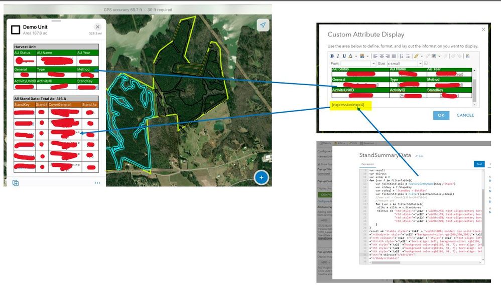

I am trying to build a popup that will work for both a Web Map in a browser as well as Field Maps.
I can build part of the with regular HTML Formatting with the fields that come from the layer the popup is based with (this are the fields with the Green Headings).
The issue is with the section with the Orange Heading.  This is an arcade field (highlighted yellow) that contains a relate and builds an entire HTML based table from the main layer to another table in the map (lower right part part of first screenshot using FeatureSetByName).
The good news is that everything works in Field Maps (and Pro for that matter) as you can see in the first screenshot.
The problem is that the results of the Arcade field are displayed as raw HTML in the popup in the Web Browser.
Is there any way for the HTML coming from Arcade to be displayed as a table when looking at it it in a browser?
Will Field Maps and Pro continue to work the way it does now?

@GregDunnigan - you could also try authoring your Arcade expression via the Arcade popup content element. Here's a blog that explains how it's done: https://www.esri.com/arcgis-blog/products/arcgis-online/mapping/part-1-introducing-arcade-pop-up-con...
This solution should work in Field Maps and Pro 3.0.
