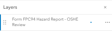

Pretty sure the problem is with the FeatureSetById. I've also tried FeatureSetByPortalItem but not having any luck in getting it to look at the features in the layer. Thats the point I've managed to get it to work up to. What am I doing wrong here? That is my layer name as per the map layers.

I've been experimenting since my original post, so I'm confident the loop part is OK, but it can't actually access the layer to do the loop. I had the same concern about the loop getting large and slow over time so added in a filter prior to only get the last month of records which should keep it manageable. Just need to find a way to get it to read the whole layer in the first place.
I've just tried this but still no joy:
var features = FeatureSetByName($map, 'Form FPC94 Hazard Report - OSHE Review', ['Hazard_ID'], false);
