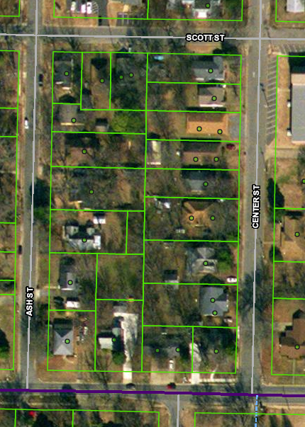

The labels appear correctly in ArcGIS Online, but will not draw in a web application that calls on that AGO map. Has anyone come across the same issue?
Labels in ArcGIS Online Lack of Labels in Webmap

Which version of the JS API are you using, 4.x or 3.x? Labeling isn't supported in 4.x yet. I was able to verify this in a 4.x app, but noticed the expected behavior in 3.x...
4.x test case: JS Bin - Collaborative JavaScript Debugging
3.x test case: JS Bin - Collaborative JavaScript Debugging
