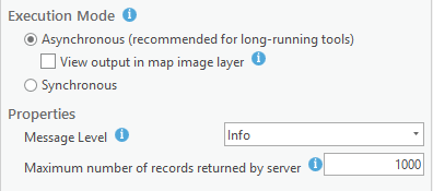

After testing the tool, it's simple matter to create an empty result and publish it to Portal:
For this example, I also enable messages to be returned:

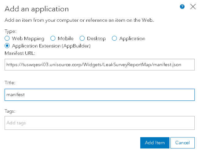

Publishing widgets to Portal can be tricky: our production Portal sits in a DMZ, and https calls to another server behind the firewall will fail, so widgets must reside on the Portal server. And even though our "Q" Portal sits behind the firewall and can see other servers, it's on a different domain. Thus, if I choose to host "Q" widgets on a different server, I need to configure CORS.  Here's an example of web.config:

The file sits in a virtual web folder called "Widgets" with any widget folders to publish placed under that. When publishing a widget, initially there may be a CORS error:
but reloading the page and trying again should work.
Once the widget is published to Portal, it can be added to a new or existing application, and it's ready to use:
