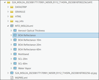

by Esri Contributor
Hi,
Can you confirm if you have used the Sentinel- 2  L2A imagery - BOA Reflectance as shown in the below image? In case you have used your own composite, try again with BOA Reflectance - the model should work.
