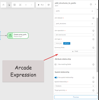

I actually put some thought into it and tossed out a bunch of ideas and settle on the one below where you could add a custom Arcade expression for summarizing data to bring back one value.
Adding portal functions to the field calculator could slightly violate the visual  presented in data pipelines.
However, if you could attached more than one input source to the calculator that might work.
