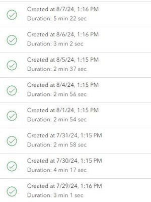

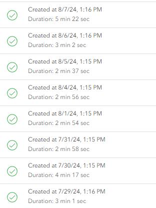

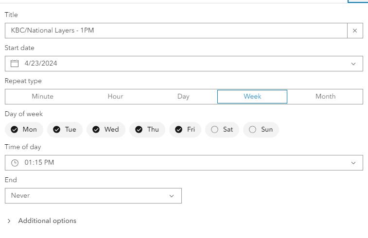

Just recently we figured out that the day scheduling function is off by 1 day. Our standard schedules are set to run Mon-Fri 4 times a day (one scheduled run per time). However, looking at the history of runs, the pipelines are actually being triggered Sun-Thurs.
Was this intentional or a bug?
See the attached snips of our schedule configuration and the history.  Note the dates on the history 8/4 (was a sunday).

Thank you for reporting this @JamesDrumm2 !
We will fix this in the next update of ArcGIS Online (late October).
In the meantime, please set the schedule to run one day ahead (so instead of Monday-Friday, specify Tuesday-Saturday).
For your reference, or for anyone else who runs into this, the Esri Support bug number is BUG-000170149.
