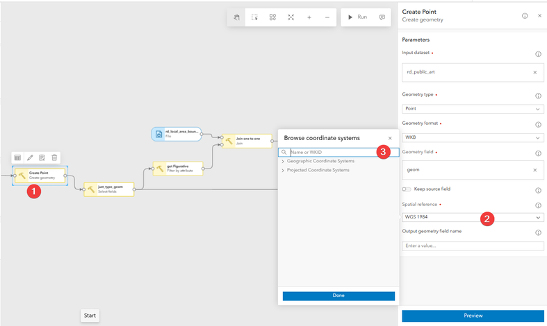

On step 3 enter 4326 into the search

Try setting the SRID to 4326. The coordinates are being plotted as meters.
I will try to post a screenshot shortly.

Thank you. Input 4326 in the search box and got the spatial reference "WGS 1984".
rob_hewy
