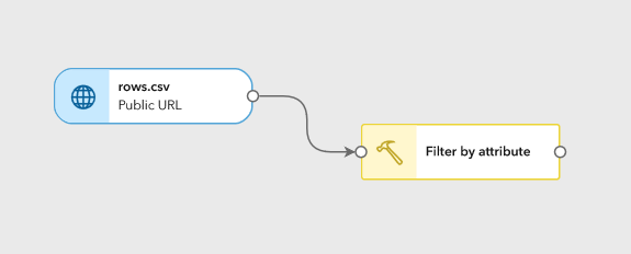

Step 2: Filter the dataset to only include new residential building permits.
  1. Add a filter by attribute tool from the Tools list and configure:
    1. Connect the Filter by attribute tool to the Public URL input from the previous step. Here is an image of what your data pipeline should look like after adding Filter by attribute:DuncanMackey_0-1686840251093.png

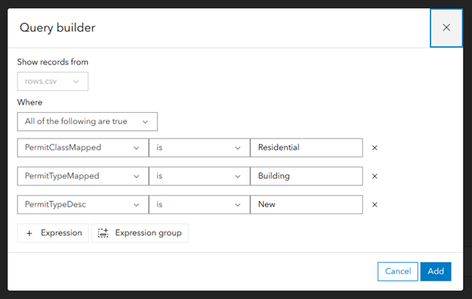

    2. Click the Build new query button to add a filter expression
    3. In the Query builder dialog that appears, select Expression and click Next
    4. Configure the query as follows:
      • PermitClassMapped is Residential
      • PermitTypeMapped is Building
      • PermitTypeDesc is New
6. Click Add to save the filter expression
7. Click the Preview button on the Filter by attribute tool pane to inspect the results
