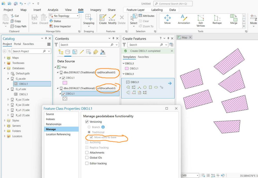

This question is still valid in Pro 3.0.1. What is the benefit of enabling the “move edits to base” option for versioning?
Basically, the advantage of having a version is to avoid editing the production data and thus edits are performed in the version and transferred to the production with the “post” tool when required

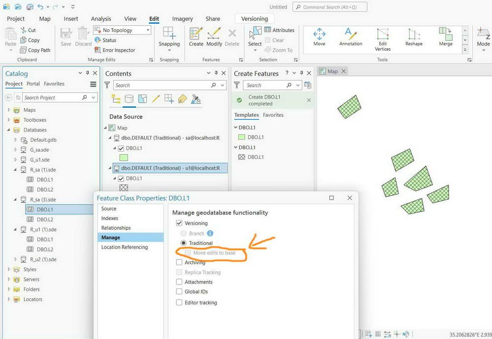

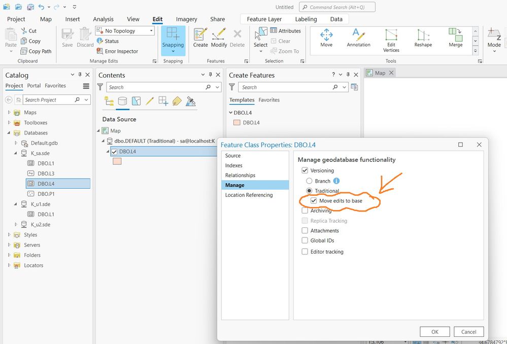

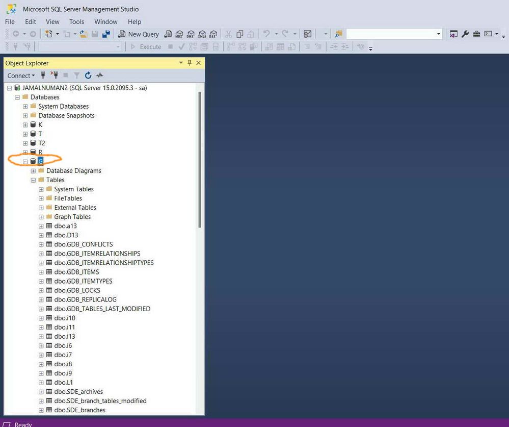

In terms of feature class, the traditional versioning with or without enabling the “move edits to base” option is the same. Edits performed by any user (who has edits privileges) are transferred to parent immediately either way.
Can the difference only be felt at the level of SQL database? How?

If a user edits a named version, other than the default version, then I suspect those edits would not be visible in the default version (the feature class) via SQL until the user reconciles and posts the named version to the default version.
