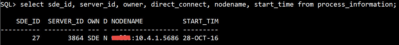

However, it is it still possible to see users connected a few other ways. The simplest method is to do a selection from the Geodatabase process_information table. This should have the same information you were seeing from sdemon -o info -I users. This table by default is accessible through the public role, so any user will be able to select from it.
I know this goes without saying, but only selections should be run against this table, no edits.

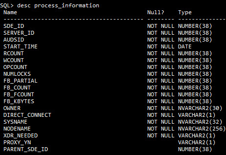

If you want to query the process_information table, you can follow my steps here. This table is owned by the GDB administrative user, so you may need fully qualify the table name. Keep in mind, I am showing Oracle for this one, but it will appear slightly different for SQL Server or PostgreSQL.
Description of the process_information table columns are here:
System tables of a geodatabase stored in Oracle—Help | ArcGIS for Desktop
SDEMON:
SQL:
