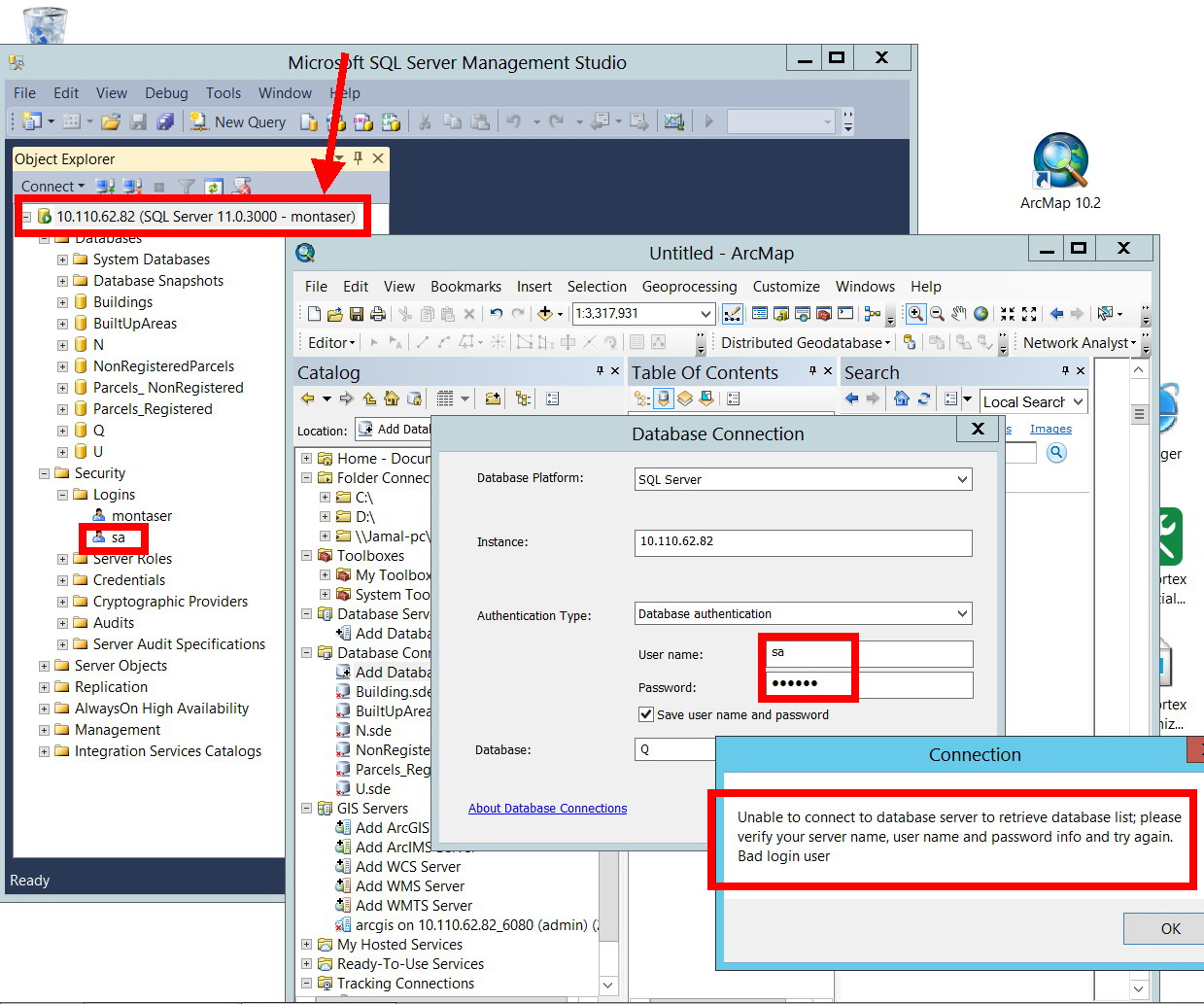

I couldn’t figure out why I’m not able any longer to access my SQL database with sa knowing that the password is not changed and the option of expiration is not check.

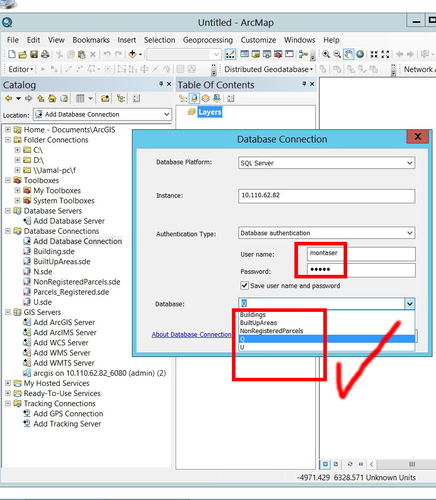

I tried to access it with other user (montaser) and it works fine!

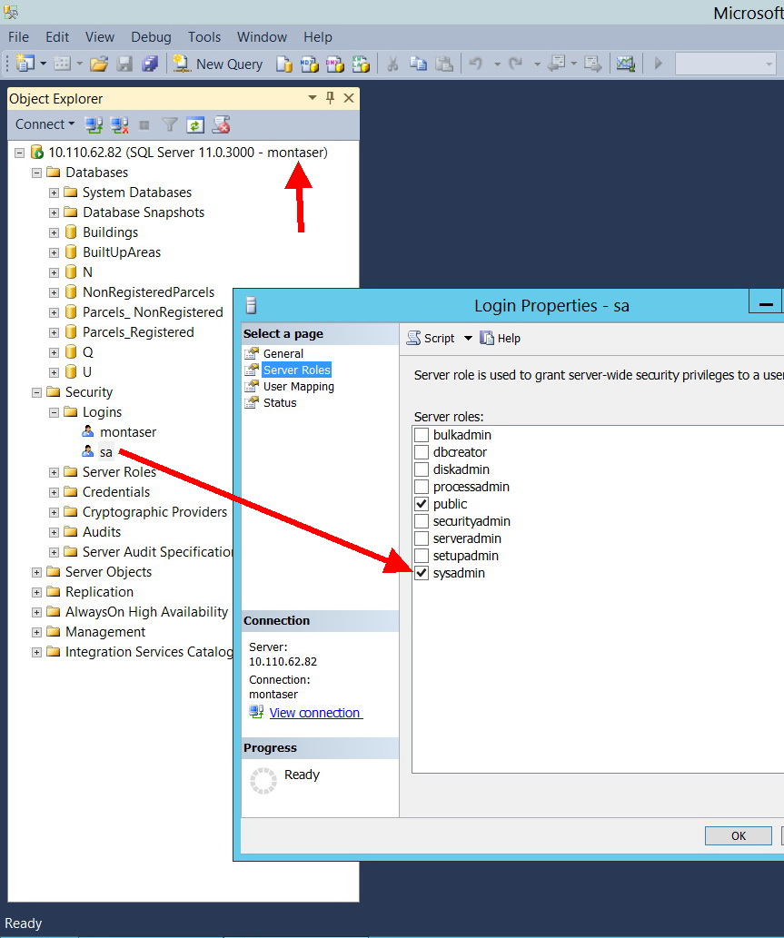

Is there any chance that the password of the sa is change accidentally?
What other issues should I consider?
Is there any way to change the password of the sa?
Thank you

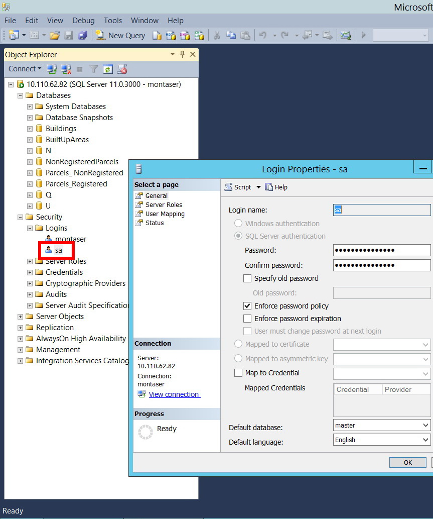

Now, I wanted to change the password of the sa to ensure better security but I got the message below
What might be the issue here?
Jamal Numan
AsrujitSengupta
Deactivated User
Uncheck those two options and try again.
JamalNUMAN
Legendary Contributor
Thank you very much Asrujit for the help. It works like a charm
Best
Jamal
Jamal Numan
ScottDean
Deactivated User
This is because the account has picked up either local or domain policies.  You can change this policy by specifying CHECK_POLICY = OFF, make the change and then turn this back on.
