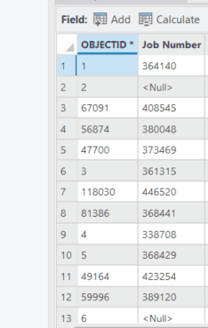

Is it possible for you to swap the column locations to the desired ascending/descending column instead of the OBJECTID column? Here is what I mean:

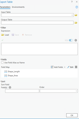

You can do it all in pro. when Exporting a table of the feature class, it has options to choose fields you want to include as well as sorting.
