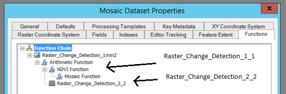

I know about that section, but my problem is a little bit different. While I can insert raster functions to the separate rasters in the Footprint (say NDVI), I cannot create a general function (at the Mosaic Dataset level) that takes as input same rasters from the mosaic dataset and do an arithmetic operation for example.
Below I attached screenshots of the mosaic, and the Arithmetic Function.
These are the rasters inside the mosaic dataset. They are a separate 1-Band Mosaic Datasets of different years. (Crated with: Creating a mosaic dataset containing raster data from multiple dates—Help | ArcGIS for Desktop )
The rasters in the Mosaic Dataset

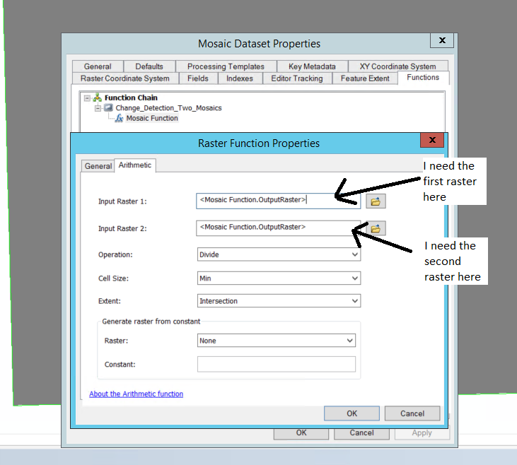

On them, I need to apply the difference "Raster_Change_Detection_1_1" / "Raster_Change_Detection_2_2" on-the-fly.
If i go to the Mosaic Functions tab, I cannot choose those two rasters.
Is there a way to do this? Suppose there is a way with raster functions, I can further use arcpy to automatically do this analysis.

One thing you can do is to create two mosaic datasets, one for each Raster_Change_Detection.  You can then apply this Arithmetic function to one of the mosaic datasets.  You will have the option to select the 2nd mosaic dataset for 'Input Raster 2'.

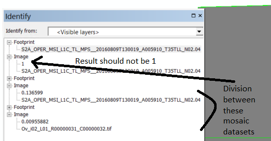

I did this, but it only processes the Mosaic Dataset on which the function is applied:
This is the raster function inserted. The first Mosaic Dataset is a one-band NDVI. I added the second one (Raster_Change_Detection_2_2) by browsing to the location on the GDB.
The processing result is not correct. The function divides the values of the same first Mosaic Dataset, and I only get a value of 1, as below:
Thank you very much!

I could not reproduce this.  I have two mosaic datasets (Stadium_2010 & Stadium_2008).  I first ran the Divide tool on the two mosaic datasets to see the result.  I then applied the Arithmetic function to the Stadium_2010 mosaic dataset specifying the Stadium_2008 mosaic dataset as the second raster.  When identifying and comparing the Divide tool result with the Stadium_2010 mosaic dataset, the results are the same.
