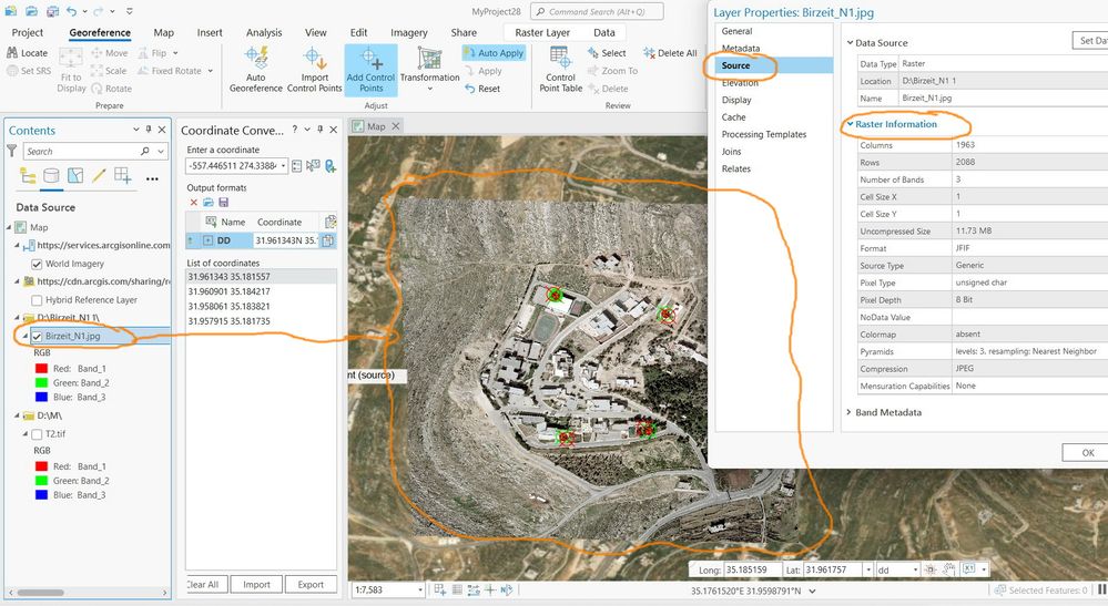

I’m getting black output in ArcGIS Pro as the georeferenced image is saved as per the screenshots below.
What could be the issue here?
is this a bug?
the image is attached

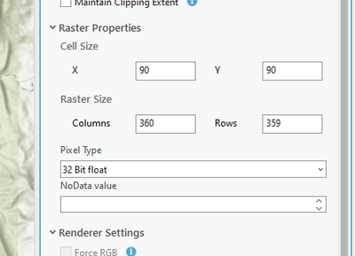

Hey @JamalNUMAN ,
Might be better to start a new one for more visibility, but I think you should be mindful of this setting.
When you save the georeferenced image, in order to catch any changes in the extent often the default is to promote the bit depth of the input image and then assign a new NoData Value. Be sure to review the properties of the image before you save it and make sure that the bit depth and the NoData value matches. For me since it looks like you are using a jpeg, I might convert it to a tif first and then georeference that. Sometimes jpegs can be touchy when georeferencing in my experience.
