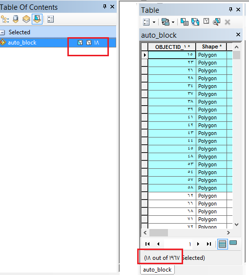

How you get that number ? from attribute table or in TOC?

sorry, I miss understand,
so why you copy paste? why you don't try to export table ?

Try to get scroll bar to the end of attribute table before doing copy. and keep the attribute table opened while you paste in excel ( don't close attribute table ).

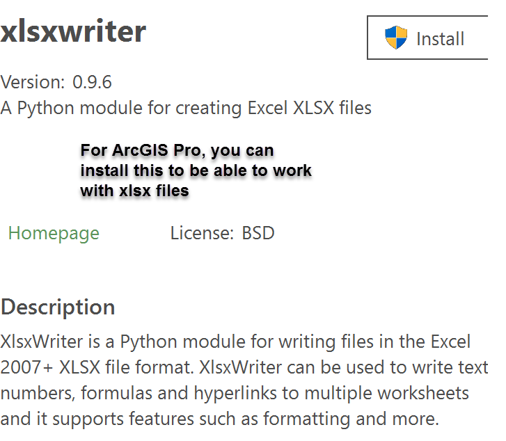

I am not sure I follow, since there is the Table to Excel tool albeit older,
Table To Excel is able to convert only to Microsoft Excel 5.0/95 Workbook (.xls) format.
but there is nothing fancy that most conversions won't work
If you need higher end xlsx files, then ArcGIS Pro's conda distribution allows you to install xlsxwriter, if you are so inclined to work with python and need to automate a workflow.
xlsxwriter conda package
