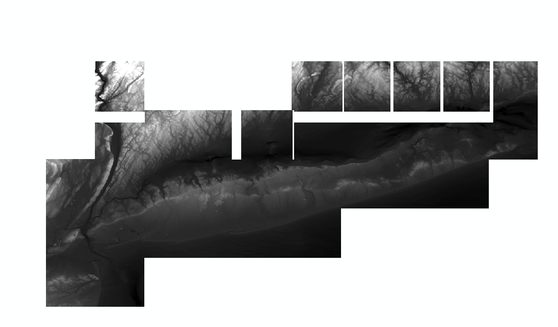

I have 33 DEM tiles that I am trying to mosaic together using this tool in ArcGIS Desktop,
tiles
but I keep getting strange results.
All of the DEM pixel depths/sizes are 32 bit float, 1 band and are in NAD83, which I have been specifying in the tool. I'm saving it to a gdb and not specifying a cellsize. I am also leaving the mosaic operator and colormap modes as the defaults. This is the result I am getting:
mosaic_32bit
Wondering if anyone knows why this is happening.
I tried using a mosaic dataset, but I am having issues with performing additional manipulation of it after I added all of the tiles. I would prefer to use the mosaic to new raster as I know the additional analysis and manipulation I need to perform has worked in the past.

Someone else recently had this issue and it was solved by creating the new mosaic in a regular folder then moving the resultant raster back to the gdb.

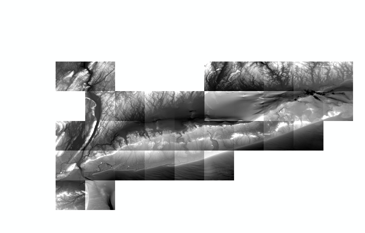

Could you change mosaic operator to Mean and retry?
MichL
Thanks for the reply Abdullah!!  I tried your suggestion, but now I got this as the result:
mosaic_mean
I'm going to try the other suggestions now.  Hopefully one of these works!!

This solution worked.  Thank you very much.  Strange that you have to do it this way though.
