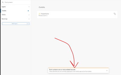

In the past, I've achieved this using Field Maps to interact with the mapped assets. In the pop up for each, I would build a URL to "carry" data from the parent feature to the inspection table to link Survey123, where the inspection would take place. I'm pretty surprised that Field Maps hasn't already put this into practice. As of last year's Dev Summit, "add a related record" is on the road map.
In fact, I just tried this myself. It's still not a thing. FWIW, I published a small sample dataset if you wanna copy it to your own AGOL and make it your own.
