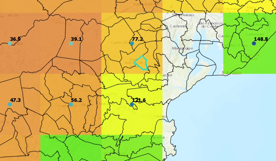

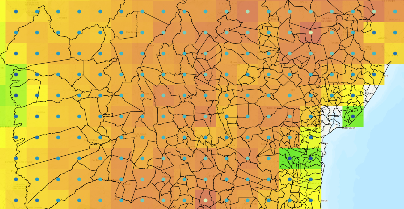

Just downloaded some municipalities for the Bahia area. There are some larger municipalities that have several points inside, but also some that have none:
Maybe it would be better to:
  • Extract the area for Brazil (point data)
  • Determine a cell size that is small enough for each municipality to be represented by one or more pixels
  • Interpolate the points to create continuous surfaces, would require you to do this for each attribute (month)
  • Extract the data using Zonal Statistics to link stats to municipalities
I really think you will need more detailed climatic data to be able to do something at municipality level:
