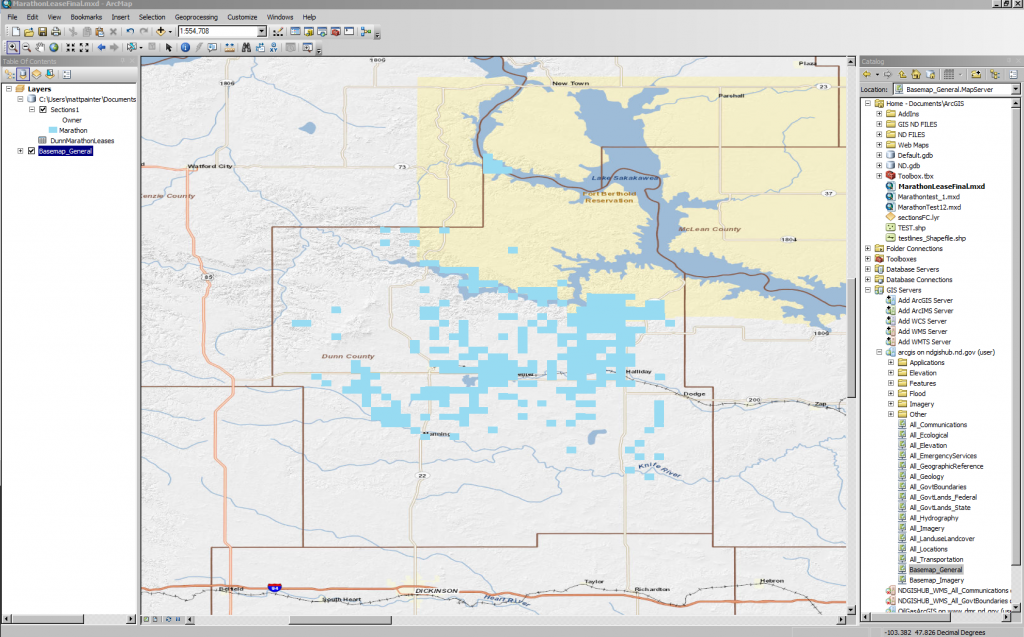

MatthewPainter1
Deactivated User
Thanks for helping me out so much i finally got it how i needed it, when i copied the section layer and unchecked null values from the symbol tab everything showed up?
I learned a ton doing all of this. I really appreciate you walking me through most of this.
RichardFairhurst
MVP Alum
I am glad it is working.  I noticed you are still in Source tab view in the Table of Contents.  Switch to Display view for most of the time.  It is the only view that lets you change layer order.  Also, Source tab view slows performance, because the hard disk is queried for the source directory information every time the map refreshes.  That query can be very slow, especially if you ever use SDE geodatabases someday.  Source tab is only valuable if you need to see the source of the data, change SDE versions, or see the list of standalone tables in the map or remove them.
