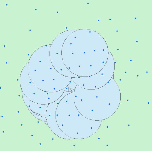

I have a feature layer of 25 buffers, which are the light blue circles you see. Let’s call each buffer a community. Many buffers overlap. Each buffer has a unique ID.
I also have a feature layer of points (centroids). Some of the centroids fall within certain buffers, some fall outside. Every centroid has columns of information associated with it, two of which are important to me: Origins and Destinations.

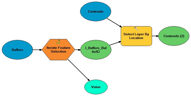

- I am using the Feature Selection Iterator in ModelBuilder to loop through the buffer file. I have chosen to group by the BufferID field.
- I use the Select Layer by Location tool to select the centroids that are ‘completely within’ each iterated feature in the buffer file. (The buffer is the selecting feature, the centroids are the input feature layer)
- The output of this geoprocess, labeled Centroids(2) in the image below, is, I believe, the collection of centroids ‘completely within’ a particular buffer.

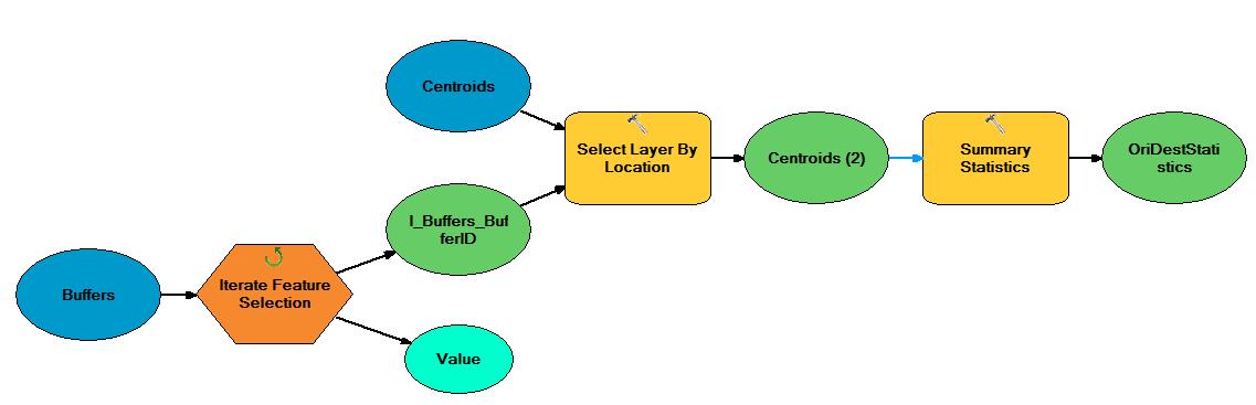

- I use the Summary Statistics tool to calculate the sum of the Origins and Destinations associated with Centroids(2). In the Summary Statistics tool interface, I select Origins and Destinations as statistics fields and I calculate their sum. The output of this tool is a table. I select the location of this output table.
PROBLEM
- This is where I am stuck. If I run the model above, I get this:
- This is interesting, because I see the tools turning to red as many times as there are buffers – so I believe that the model is iterating through each feature in the buffer layer, selecting centroids by location, and creating summary statistics.
- Clearly, though, I have not set up the model properly to get the desired output because the resulting table has only one row. There should be as many rows as there are buffers, which in this case is 25. Moreover, I would like the OBJECTID* in the above image to be the BufferID from the buffer layer. When I grouped the Feature Selection Iterator by BufferID I thought this might carry over to the Summary Statistics; it did not.
- Although the model is iterating 25 times (as evidenced by the tools turning red 25 times when I run the model) the output it generates is for one iteration only. What do I have to change in order to get: (A) a table with 25 rows, and (B) an ID that corresponds to the BufferID?
