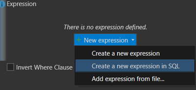

However, I'm not sure what SQL statement should be given. I tried something, but it seems to be wrong. I don't know whether that is cause I have an older version of the program.
JohannesLindner
MVP Alum
Try it without the quotes. Just
layerdikte.BOTTOMSAND - layerdikte.TOPSAND >= 3.5
Have a great day!
