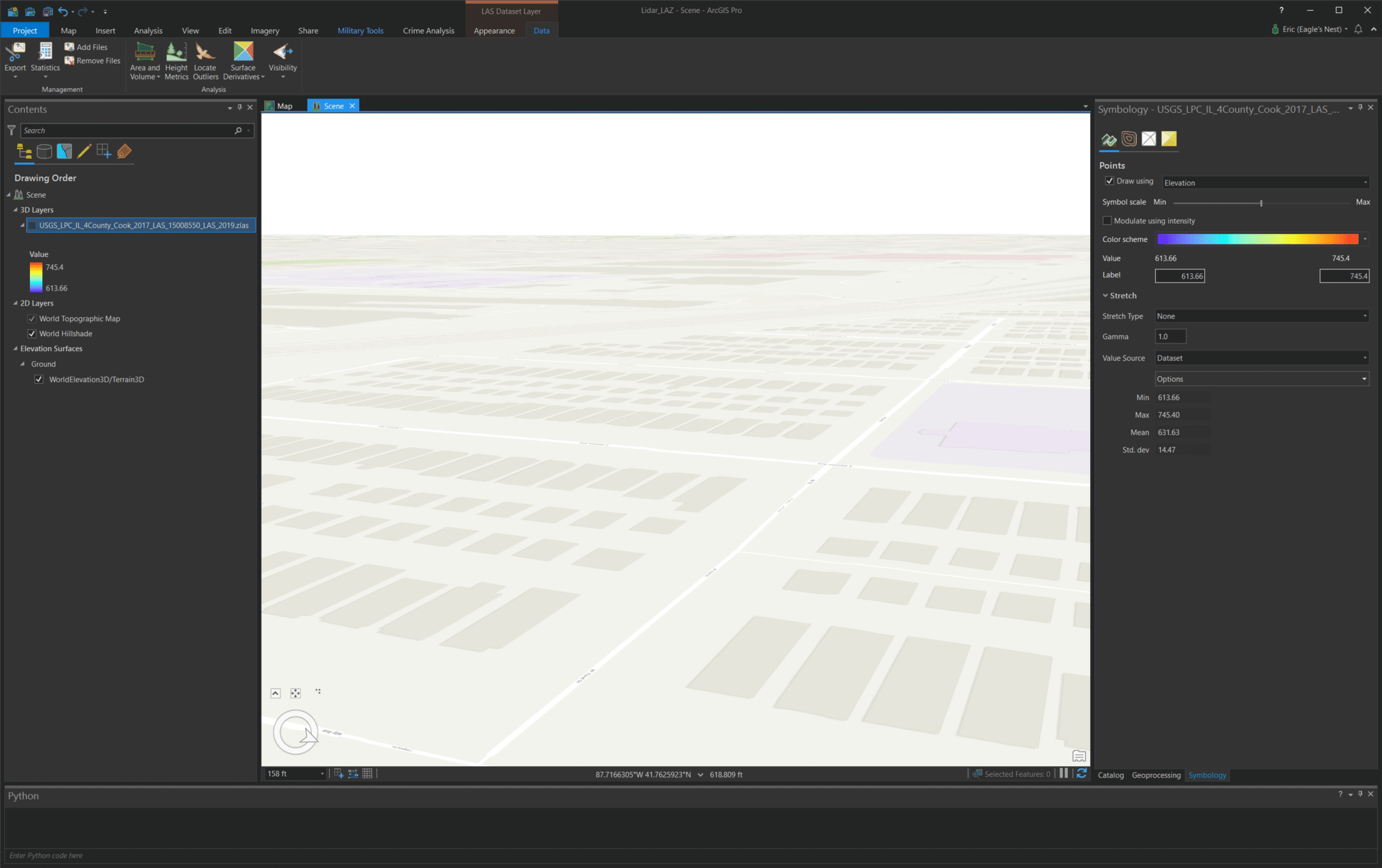

I have a point cloud. I would like to load it all.  As you can see in the below recording, ArcGIS Pro (2.5.1) is doing something under the hood to restrict the number of dots being drawn.
I'm using a .zlas file here, but the same behavior occurs with uncompressed data (.las).

does it have to do with point thinning?
Point thinning and scalability of a LAS dataset—ArcGIS Pro | Documentation
some options only apply to 2D views

EricEagle
Awesome Dan, that worked!  Thanks for the fast reply.
