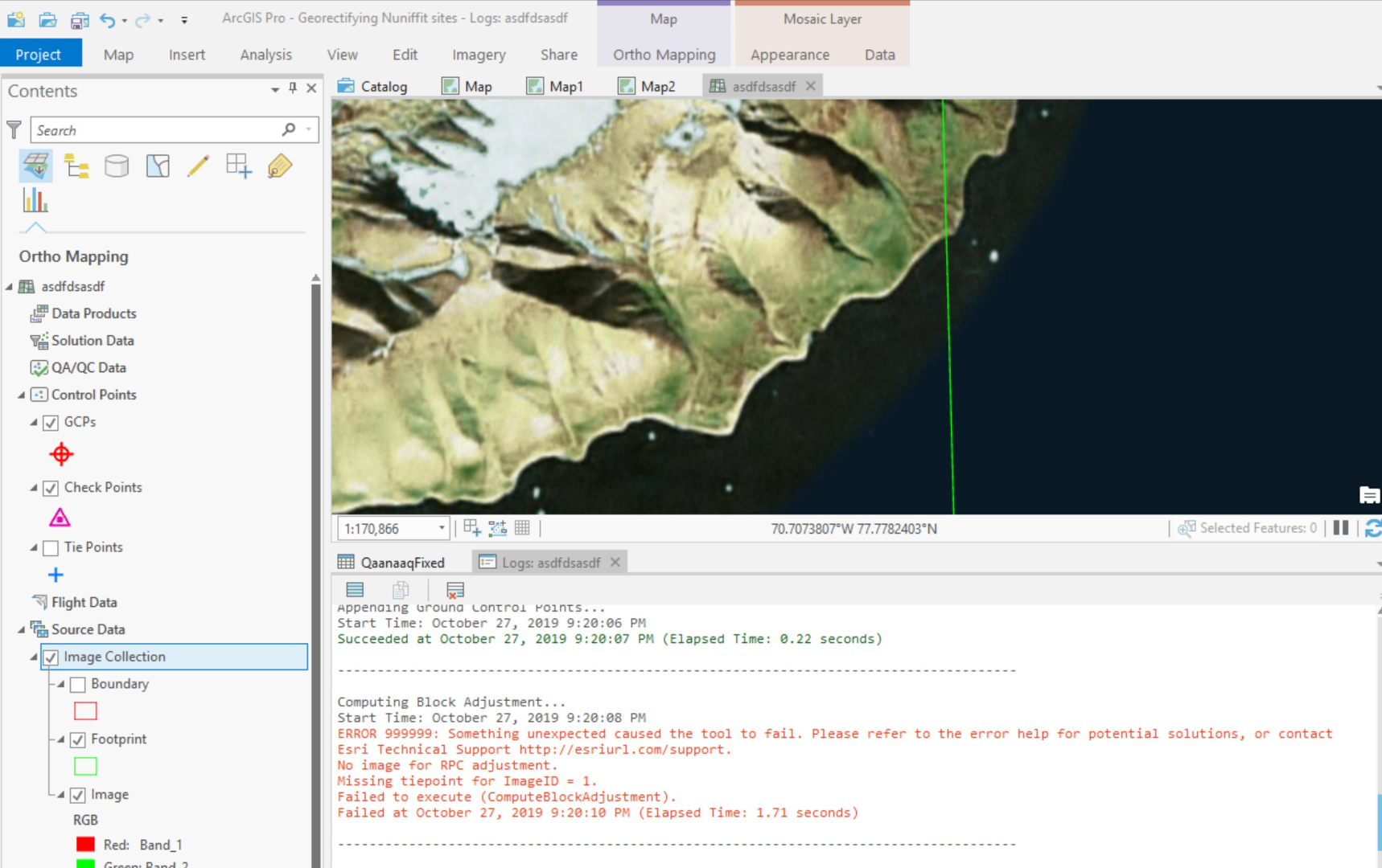

I think I'm way out of my depth, and have been trying to orthorectify Worldview images from Digital Globe for weeks without results. It seems to me that the problem is getting ESRI software to read the RPC information which is actually stored in an .rpb file. I have the ORstandard2A bundle of images -- so there are seperate .rpb files for both the Multo and Pan images.
I go through the steps to do a block adjustment, via the Ortho Mapping workspace. I have a good DEM for the area, but when I run the block adjustment it always runs into an error, and says "no image for RPC adjustment".
Have been through any and every discussion on .rpb files without an insight - any help you can offer is much appreciated. Thanks
