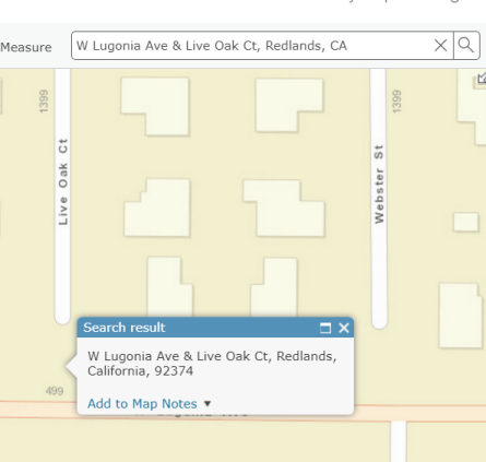

Disconnected intersections are now supported by the ArcGIS Online World Geocoding Service:
Dead-end intersection
REST request:
http://geocode.arcgis.com/arcgis/rest/services/World/GeocodeServer/findAddressCandidates?SingleLine=...
You can find more details in the developer documentation:
findAddressCandidates—ArcGIS REST API: World Geocoding Service | ArcGIS for Developers
Matt
