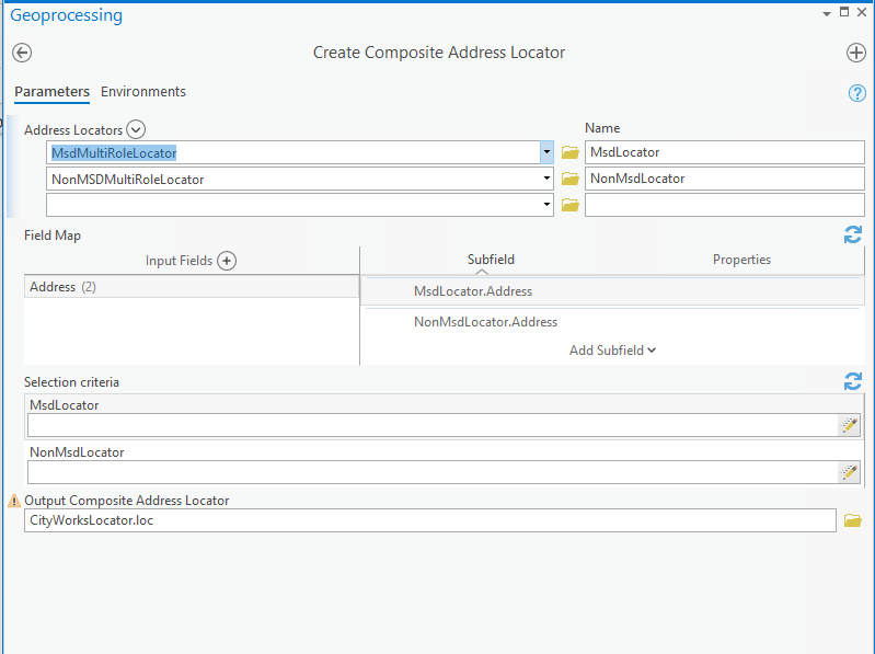

Just started using the Create Composite Locator tool and now I am scripting it in python to automate the process.  My python works, but I don't understand the field mapping portion of the tool and subsequently what I am providing to my script.
Here is a snapshot of the tool and parameters:
I purposely whittled down all the various input fields that appear by default, since I don't understand what they provide the tool.

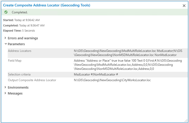

When creating python scripts for geocoding, I always use the tool history details as a means to provide me the parameters of a successful tool run:
The resulting function in my script creates the composite locator just fine:
