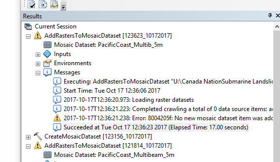

Creating a mosaic database in ArcCatelog and when I try to add data raster to my newly mosaic file, I keep getting this error message: 8004205f: no new mosaic item was added. I have looked on this sight for similiar issues but did not find anything that could help me with this issue.
I am bringing in the raster from layers that have the bathymetry, relief and multibeam. Ideally I want to create the mosaic with the multibeam, but still can not work this out. I have tried to just use the mosaic to raster tool, but this have come up with it own errors.

I tried that, but still having the same error. I also created a new mosaic dataset and try in that one too and tried just dragging and dropping the data, but still getting that error message. Any other suggestions?

I would try to do addrasters by dataset and select one raster that exists inside the directory you give in the original tool.
The error say that you have no rasters in the directory you selected.

I think this is the issue. I am pulling data from a layer file on another drive, I didnt realize that I had to have the data in the same drive...i gather? Anyhow, I have now brought each indivual raster from each layer file into my drive and I am now using the mosaic to raster tool. At this moment it seem to be working. I still don't really understand why I could do it from a layer file, though.

AddRaster is looking for rasters, not layer files. You can choose any directory but if it has no rasters it will not find anything.
AddRaster uses the raster itself and not the information (renderer, etc) in the layer file and you usually will not have 100 layer files for 100 individual rasters in a directory.
