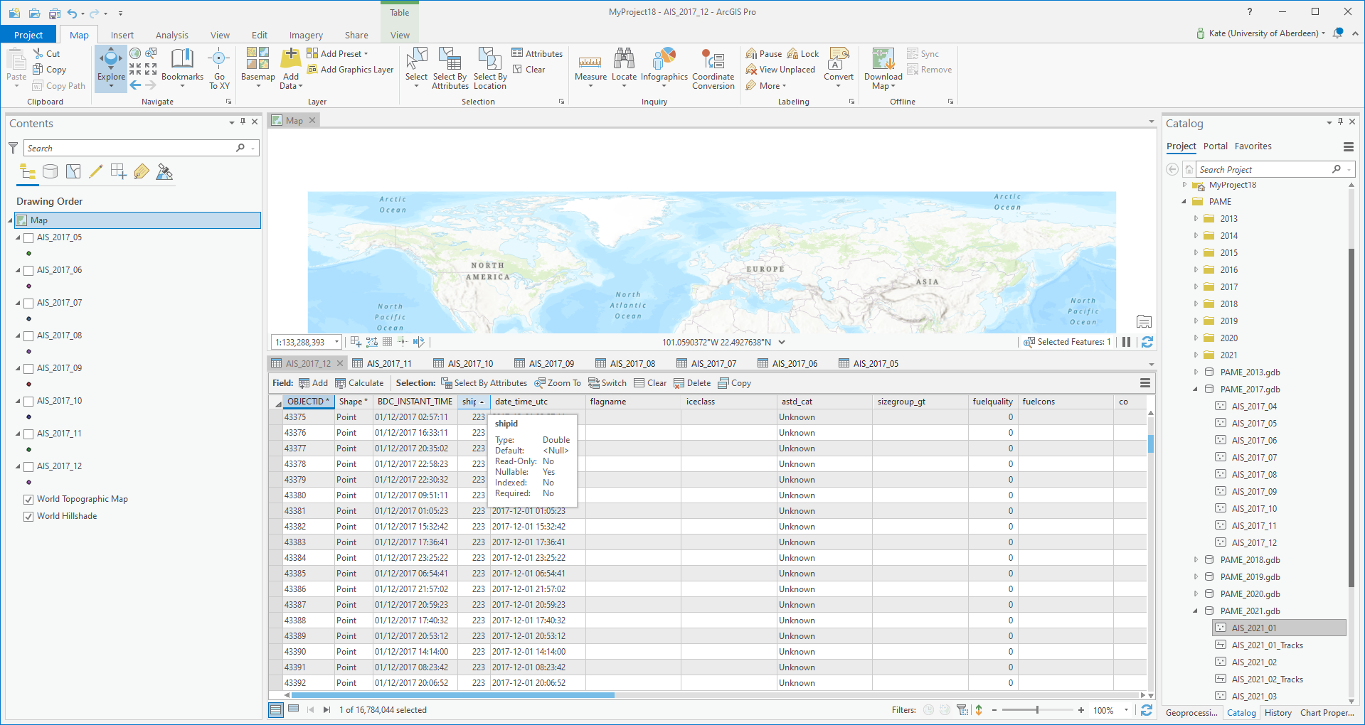

Hi,
I need to select and delete records from an attribute table where there are fewer than 10 records/rows for a particular field (shipid).  Unfortunately the data set is very large, so it's not possible to do it manually.  So wondered if there is a way of doing this via select attribute? or similar?  I'm working with ArcPro. Thanks

Kate_Gormley_abdn
Maybe not quite, but will have a look thanks - the shipID is identical for lots of records, but I only want to delete where there are less than 10 records. (some may have 100's of points for the same shipid for example)
