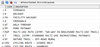

Our geodatabase is Oracle, not SQL Server. What I do is create individual views to get the domain values (codes and descriptions) for a given domain.
--This is Oracle-specific SQL. You'll need something different for SQL Server. https://desktop.arcgis.com/en/arcmap/latest/manage-data/using-sql-with-gdbs/example-resolving-domain-codes-to-description-values.htm
create or replace view d_atn_type as
select cast(rownum as number(38,0)) as rownum_, x.code, x.description, i.name as domain_name from sde.gdb_items_vw i cross apply xmltable( '/GPCodedValueDomain2/CodedValues/CodedValue' passing xmltype(i.definition) columns code varchar2(255) path './Code', description varchar2(255) path './Name' ) x where i.name = 'ATN_TYPE'
That works well for me.
Alternatively, you could create a view that includes the domain codes/descriptions for ALL coded value domains in the geodatabase, or just for a given owner/user/schema. And include the domain name as a column in the view.
Then, when you want to use a specific domain's values in your FC view, you could join to the domain view, but only include the rows that pertain to the applicable domain.
