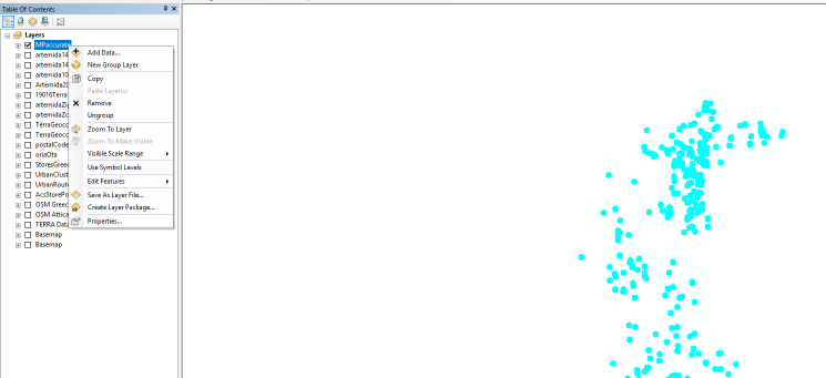

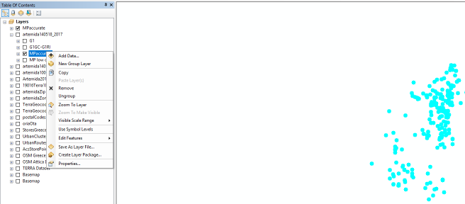

I m using ArcGIS 10.4.1 and i'm facing the following issue; I have create a group of many shapefiles, right clicking the group i couldnt find any  "data" option so i created a lyr file,
but even then in the lyr file there is no "data"  option.
Any ideas for that?

A group of shapefiles?
Perhaps you want to use the Merge tool in Arctoolbox to produce one output file.
A group layer in the table of contents is simply a way of organizing associated data, but it doesn't do any combining/merging or appending.  This is a separate process

RobertBorchert
Honored Contributor
You cannot export files to shapefiles by selecting the group.
Use the Feature Class to Shapefile tool.
that will allow you to export a large number of shape files at one time.
