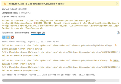

OK, thanks, that sounds like it should work, but I'm getting an error when I try to import the feature classes into the enterprise geodatabase. I'm able to make edits to features in the enterprise geodatabase, so it doesn't make sense that I can't import a feature class. Any idea what I'm doing wrong?
