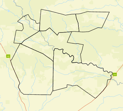

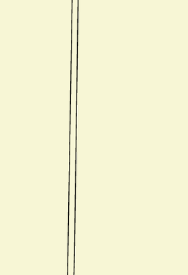

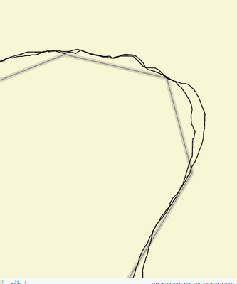

Hi everyone, I have five (5) polygons which are supposed to match. The problem is my polygon bounderies are not matching perfectly like indicated on the first picture . I want all my polygon bounderies to match perfectly or to have the same polyline kind of.
Thanks in advance
