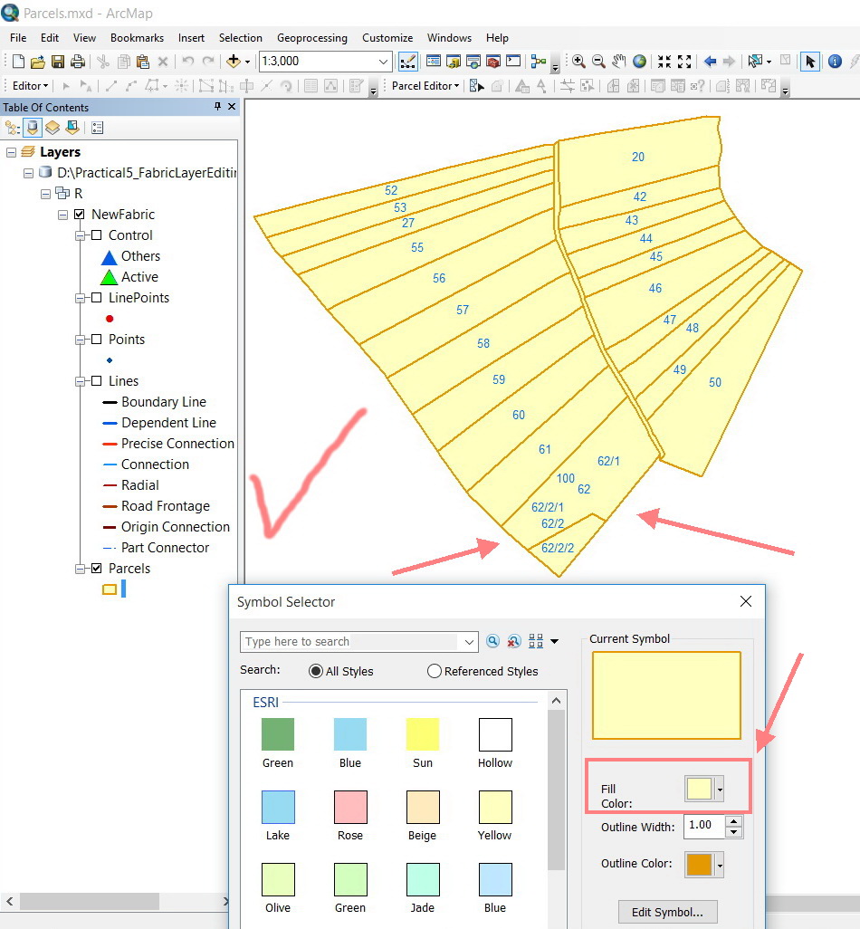

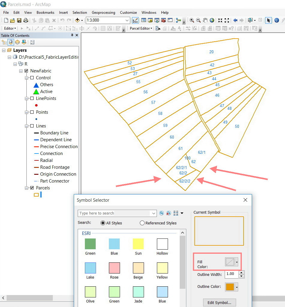

I wanted to represent the fabric layer with no fill. This appears to show the boundaries of parcles that have been already merged\split. I return, if the fabric layer is represented with fill symbology, then these boundaries get hidden.
How can I still represent the fabric layer with no fill while having the merged\split hidden?

My question here is why the boundaries of merged\split fabric parcels disappear in case of “fill” and appears again in case of “no fill” option.
Be aware that this behavior is limited to the FABRIC LAYERS, I guess!

To me it look like there could be 3 parcels 62,62/2,62/2/2 are all in one parcel if that is what you meant ?
JamalNUMAN
Legendary Contributor
Thanks Robert. This is precisely what I mean.
I still need to have the symbology for the parcels “without fill” but having the indicated boundary below in the screenshot hidden.
What is interesting is that the indicated boundary below can be AUTOMATICALLY hidden if the symbology for the parcels is chosen to be “with fill”!
What might this indicate for?

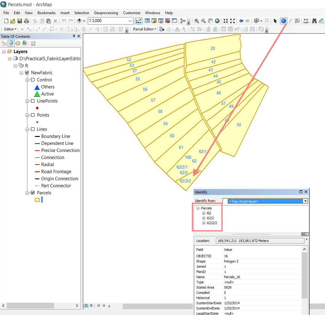

is one feature stacked over the other?  select the appropriate record in the table rather than onscreen and set your polygon outlines to 0

Have you contacted the Fabric group? you seem to be the only one ... other than the occasional esri member.... that uses them.  The question remains as to whether the geometry is stacked as in a union or whether a symmetrical difference is produced.  If it is to maintain historic lineage, then I wouldn't be surprised at all that the boundaries are retained and 'visually' they appear incorrect, however, in terms of attributes or temporal lineage they are.
