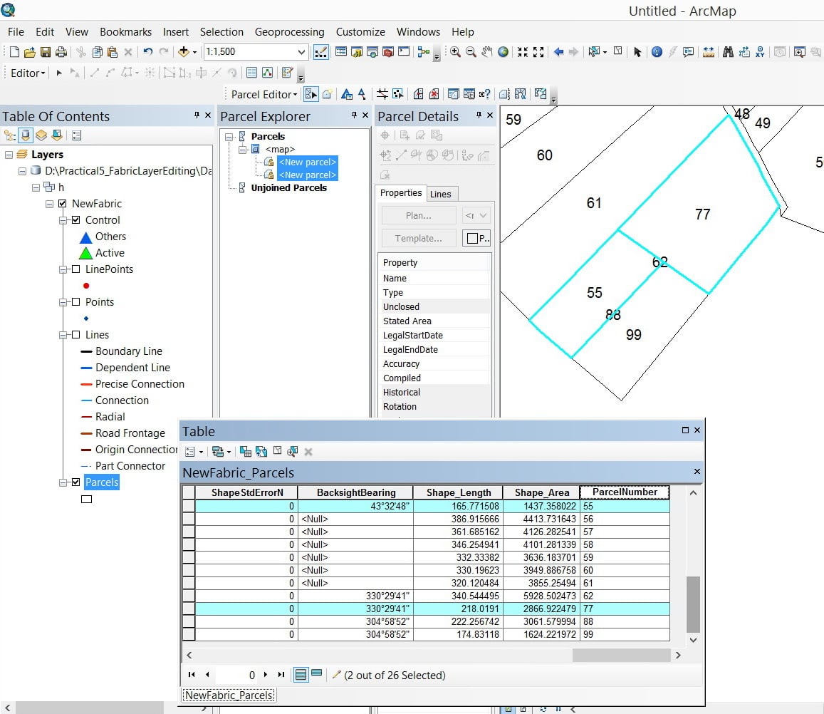

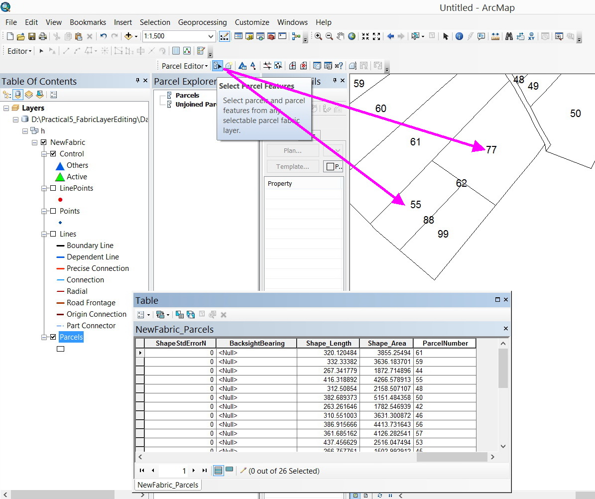

For example, in the screenshot below, I wanted to select polygon 77 and polygon 55 with the “select parcel features” tool. I failed to perform this selection with the “select parcel features” tool and finally I did it from the table!
Is this sort of selection still possible with “select parcel features” tool?

You should definitely be able to select parcels in a parcel fabric with the Select Parcel Features tool. One thing to check - is the parcels sublayer selectable? Also, for overlapping parcels, you should be able to use the selection chip to select the parcels you want. YOu must be in an edit session for the selection chip to show up.
