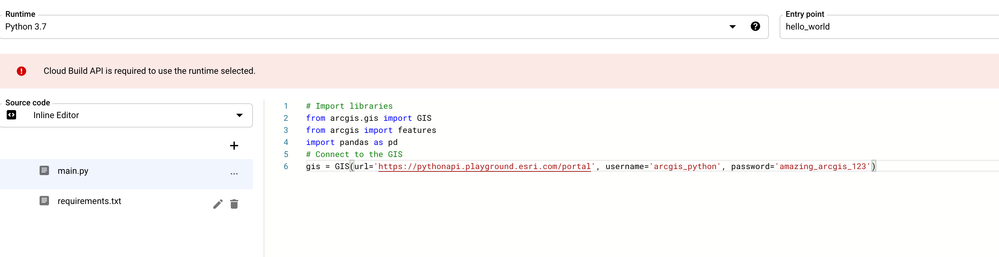

I am going to try and call https://www.fire.ca.gov/umbraco/api/IncidentApi/GeoJsonList?inactive=true&year=2021
within a google python function (https trigger)
Before I go down the rabbit hole ( i do not have experience with python) do you think it is possible to use the ArcGIS Python api in a google function to
  • populate said geojson as a layer
  • Format said layer
  • overwrite said layer (with https trigger set on timer)
Thanks again
Josh
Screen Shot 2021-05-10 at 1.04.40 PM.pngScreen Shot 2021-05-10 at 1.04.40 PM.png

I imagine you could. I have not used Google functions in ages, but I have seen users on here mention using it for certain tasks.
