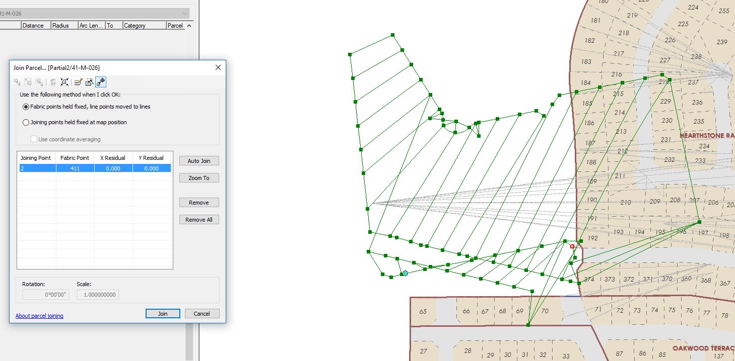

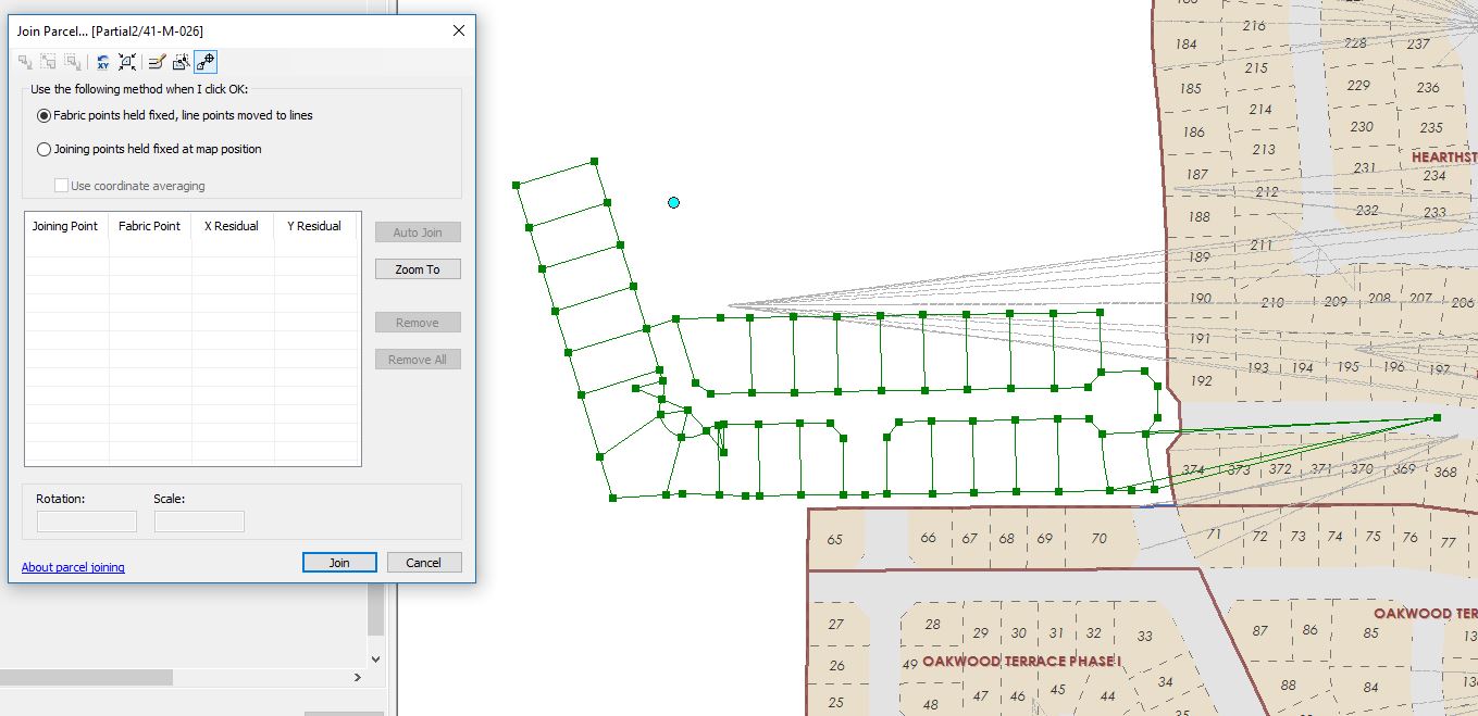

I'm attempting to add a new subdivision to a parcel fabric and its having some rather odd behavior.  I draw all the lines.  Everything looks great.  I hit join and everything still looks great.  But the minute I add a single join link the whole thing warps on me where the parcels aren't even recognizable.  Has anyone else experienced this?  Has anyone found a solution?Before adding a join linkAfter a single join link is added
