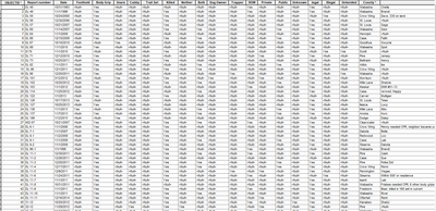

Thanks for your help.  It's entirely possible that I'm confused on the data structure.  I'm including a jpeg of the map.  I made the table from scratch and if I remember right I made a point feature class.  Then I would put a point on a specific county and it would highlight a line where I could type in the data.  That made a connection between the point on the map and data so if I clicked on the point it would open the individual record.  I'm trying to add more records to the table but so far all I'm accomplishing is to make the table without being able to put a point on the map.  Here's a shot of the current table.

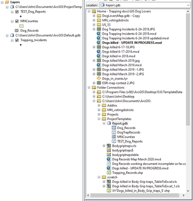

The feature will need to be toggled on in the TOC to display in the create feature window.  Also ensure that you are editing that feature and not another layer (right click on the feature in the TOC and edit->start editing).
You shouldn't have to, but you can add a template in with the add template button in the top left of the window.  You'd really to to screenshot what you have for me to offer any more advice, and also screenshot what this dataset actually looks like, and the whole arcmap screen.

Yes I got the previous images, though they didn't show what the feature type/table was.  If you're trying to edit 'Dog Records', what you have is a geodatabase table, you need the original feature class in order to create new features.  The table will contain no spatial point info.  Have you lost the original feature class?

I found the original feature class table and I can add the points that I need.  Thanks for pointing me in the right direction.
