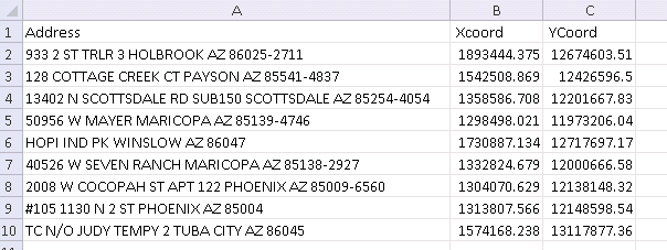

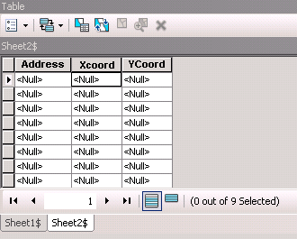

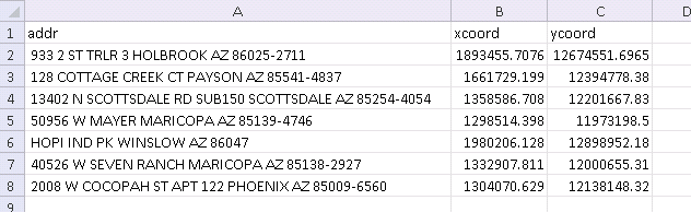

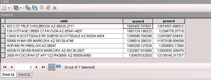

I'm using Arc Map 10.2.1.  I have an Excel spreadsheet with two sheets in it.  One sheet I can bring into Arc Map without a problem and the other I cannot.  They aren't much different.  Here are some screen shots of the Excel sheets and the data in Arc Map.  Does anyone know why the second sheet does not come into Arc Map properly?  I've read the topics in Formatting a table in Microsoft Excel for use in ArcGIS—Help | ArcGIS for Desktop and can't see what is wrong.
Excel sheet 1
After bringing sheet 1 into Arc Map, here's the attribute table for Sheet1
Excel sheet 2
After bringing sheet 2 into arc map, here's the attribute table for Sheet2.  Notice the fields are all null

The spaces in the Field Names (in Excel Sheet) may be causing the issue. Make sure there is no space in the Field Name (both before and after the FieldName text).

Jayanta is correct, you can't have spaces before or after the field names

That's downright weird.  Using 10.3.1 I can open it at all as an xlxs, but I can as an xls, but that #2 work book is all null.  Tried it in 10.0 and same thing.
I copied the contents of #2 into #1 and that worked.  Beats me though....
edited moments later:  Good Catch Jayanta-  Didn't notice them!
