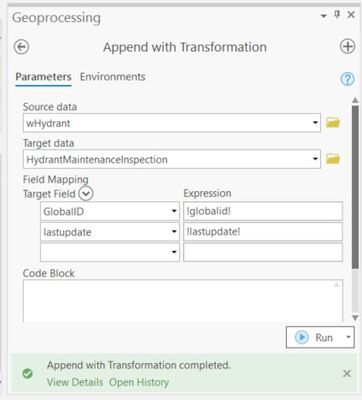

Unfortunately, the Data Loading Tools do not currently support the workflow for feature class to table, but the Append with Transformation does. You can use the Expressions column and the code block in the same way you would use the mapping workbooks and the scripts in the data loading workspace.

Thanks Alix. Could I put a Target Delete Query in the code block to clear the table before appending or is this only for individual field calculations? It would be nice to run this each time we execute a data load to ensure relationships are maintained.
AlixVezina
Append with Transformation only supports insertions. Maybe you could setup a model in Model Builder that would run Truncate or Delete Features first, and then Append with Transformation?
