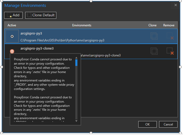

After upgrade to ArcGIS Pro 2.8.2, I tried to recreate the python clone env.  I get a proxy Error, Any idea how to fix Proxy Error?
AlixVezina
@ELIZABETH50  I'm not too familiar with how to resolve this issue, but this related post may help: Installing untools on ArcGIS Pro 2.4 behind a corp... - Esri Community
