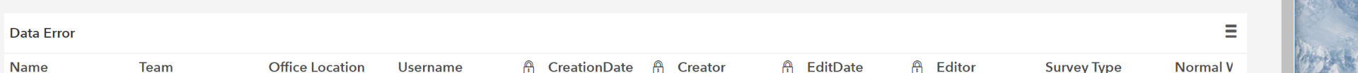

I also have an issue with personnel_current and get the following error message when I try to display the data

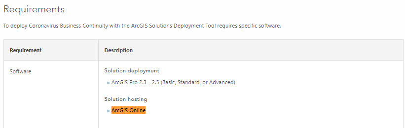

Did you link your enterprise and AGOL to have more logins?
This solution is not available on Enterprise yet only AGOL
Bogatirsky_Nathalie
No I'm using the solution on AGOL. My issue is really with the username.

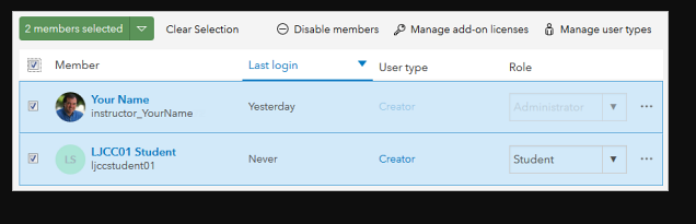

RickeyFight
MVP Alum
user name in this case is
instructor_YourName
or
ljccstudent01
that is what you would add as the user name
