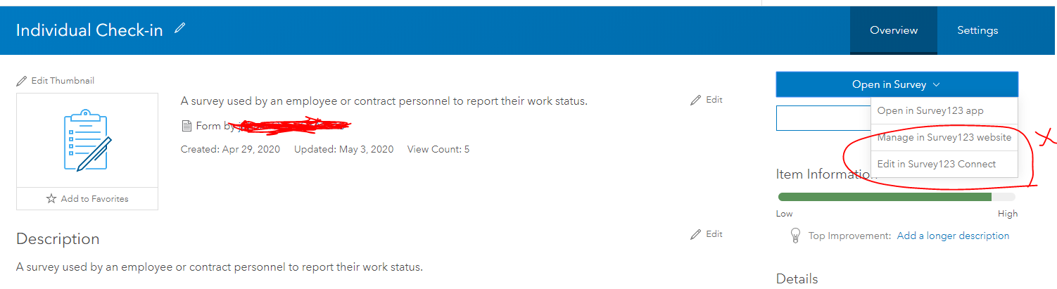

First, the survey url, is shared with the users, but they are not able to see all the options, only the native app is visible, but with the intranet restrictions they cannot use the native app, only the web forms are allowed.
So, I have shared the url from the survey123 website as below.

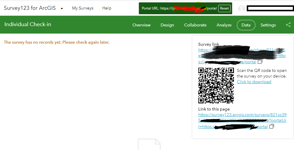

The users are able to access the check-In form and few were submitted the records,. But when I navigate to the the survey website there are no records
However, when I check the data in ArcGIS Pro I see there are records and all are created by ESRI_Anonymous except my userid. And in the Personnel status dashboard, only my record (admin) is showing.

Sorry for the delay. This is occurring because the view used by the survey has been configured with the setting to now allow anyone to query the service for records, only new records can be added. This is to secure the information and not allow anyone to query sensitive information. The side effect is the data view in Survey123 is unable to query the records as well and display them in the website.
