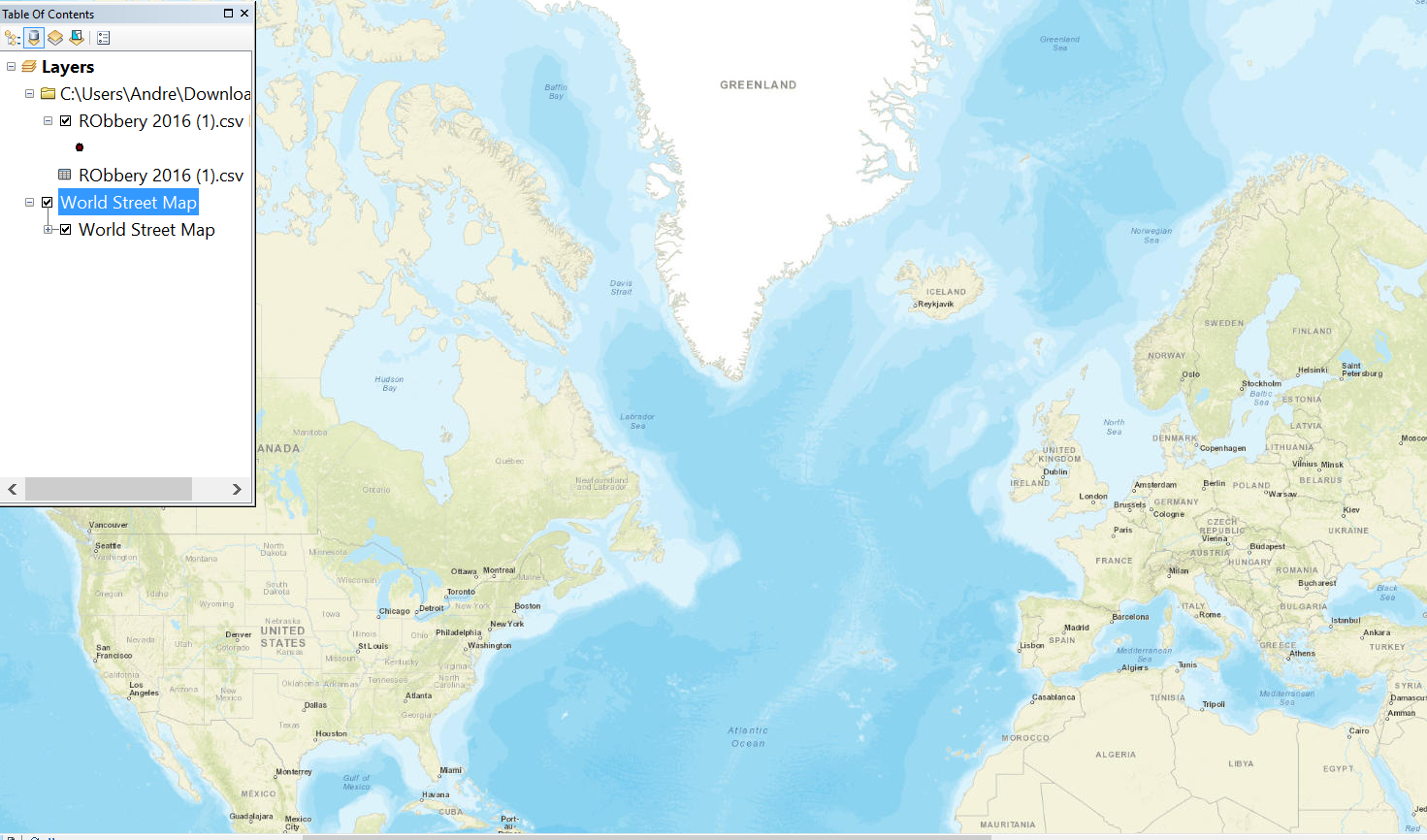

Hello,
I'm a bit new to GIS and am having a bit of an issue
I have a .csv that i have converted into a feature class- the feature class displays correctly(it is a map of all robberies in Detroit in a given  year).
I also have a .shp that is all of the locations of the lights in the same city- it also displays correctly, but in a completely different part of the map.
When I add a basemap, the .shp points are all in the correct city, while the .csv created feature class is out in the Atlantic ocean.
I have ensured that all the layers and the data frame are using the same geo reference systems.
I'm at a bit of a loss here.
I've attached both the .shp in a zip and the .csv I'm working with.  Any help would be much appreciated.

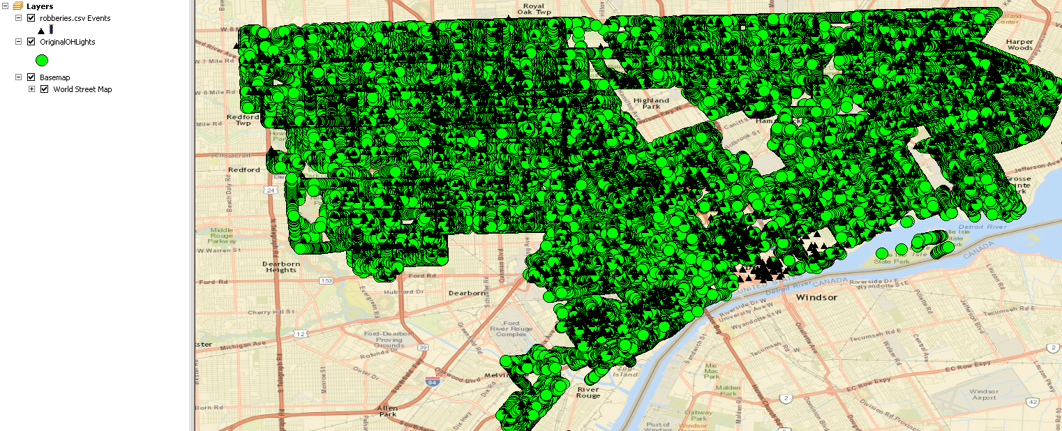

Here's what I see when I follow the workflow below:
Here was my workflow:
  1. Open ArcMap
  2. Add .csv to TOC
  3. Right-click on .csv and select "Disply XY Data"
  4. Select WGS84 as the Geographic Coordinate system, and ensure X = Longitude field and Y = Latitude field
    1. Results = robberies.csv Events appears in TOC, with points plotted in correct locations.
  5. Add OriginalOHLights to TOC
    1. Results = OHLights points appear in correct location

I followed that exact workflow, only to end up with a the map zooming somewhere in the area of greenland
AndreMasnari1
Deactivated User
Nevermind, I am a dork and messed something up.  In any case, it works now.  Issue seems to be I had a projection of world_auxilary_sphere 1984 chosen.
Thanks for the help!
JoshuaSchwartz
Deactivated User
ArcMap will always set the dataframe's projection to the first dataset's projection that you add to the TOC. I suspect you had the World Map basemap in your TOC prior to doing anything else, which would explain the world_auxiliary_sphere 1984.
