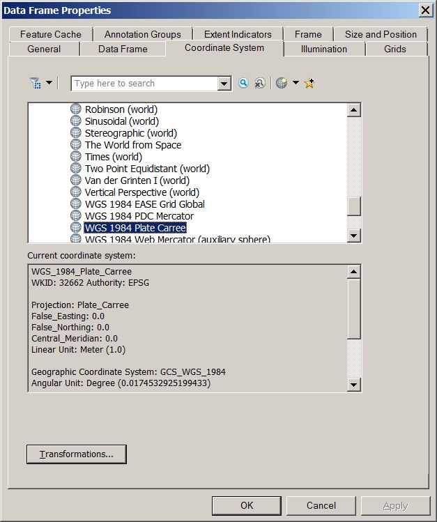

I see that there is a projection definition for a "WGS84 Plate Carree" in the system.
See here..
This map is showing the Nat Geo basemap. With the zones on top. It is a little more "stretched" east / west than a typical UTM zone.
If you set up your data frame like this, then add the image tiles, everything will be reprojected into this system.
No datum shift is necessary because both are WGS84 based.
Then you could export them again using the coord sys of the data frame. Or try Jayanta's idea of simply importing them into a mosaic that has its coord sys already defined as WGS84 Plate Carree.
See here..
