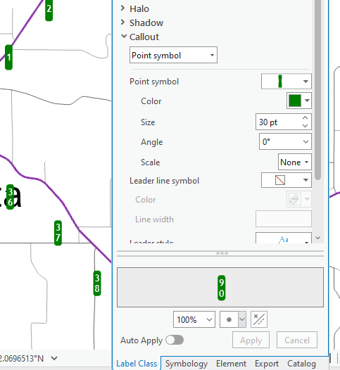

Hi Julia,
I'm currently working on this. Early on, I ditched symbology for label class and created exactly what I wanted.
Here's what it looks like:
-ChrisCraig
I came back to it, because I think I'll have better control over my icons if they are a symbology class.
