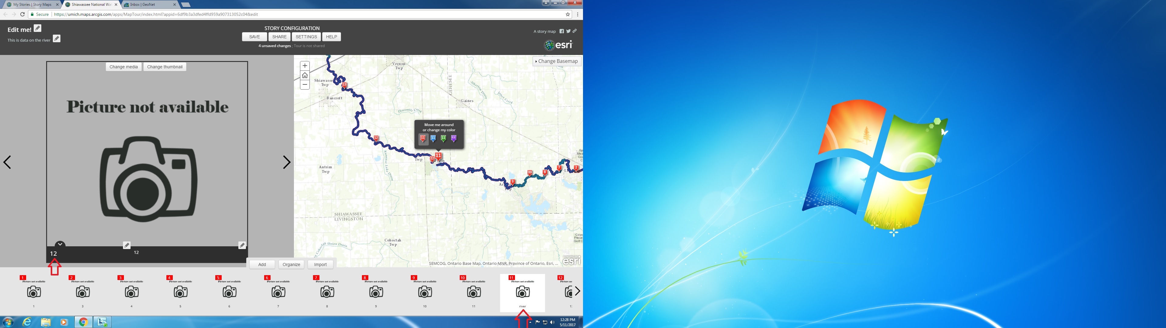

Working on my storymap and it will not let me input a link for a photo to an existing point. Also when I give the thumbnail a title it deletes it. Another issue is if I add a point with a picture storymap wont save it and it wont let me get back into my map.

I am using google chrome, firefox gives me the same issue. This is when I type in what the title is
                                                                                             This is what it says when I put in the title, both are labeled.
This is what happens when I click another slide or do anything else. The title goes away but stays on the bottom bar. Eventually they both go away.

It sounds like the whole map is broken. Is there a way for you to change the media and/or change the thumbnail? Would that make a difference (and do these changes persist)?

No I cannot, when I try to change the thumbnail it just loads and then does nothing.

Hi Tyler,
It looks like you are working with a Feature Layer for your Map Tour layer.  Try updating the capabilities of that Feature Layer to include Add, Update, and Delete Features.
