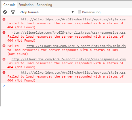

Having trouble configuring a short list story map to open via URL. I know the folder is live; I can open the Readme included with the app by typing in the URL. Shows up as just the app template with a spinning "circle of death" that never leads to final error messaging. Points to ponder: Hosting via GoDaddy. Configured webmap id, color order, etc. in HTML index as per the tutorial. Images are hosted on flickr, with complete urls (including album) in the table attached to the (publicly shared) web map.
Any help would be realty appreciated.

The css and js folders/files need to be in a folder named app in that root.  If you open the developer tools of the browser you are using, you will see it is failing to find and load these files.

How about providing the URL of the Shortlist and of the web map you are using so we can have a look?

Sure! It's still very much a draft with some incomplete pieces... I want to make sure I can get it live before I sink too much effort into it.
web map: http://www.arcgis.com/home/webmap/viewer.html?webmap=ed1a40e804f748fb85dba975be0ee224
short list: Shortlist
current index.html file:

MarkCooney
You will need to include the css and js files in your folder (which in the download, are stored in the app folder).  Add these back in, and your Shortlist should load just fine.
-Mark

screenshot of the folder contents:
ajrobinson3
Deactivated User
The css and js files are stored in the same folder on GoDaddy's File Manager with the index and the Readme pdf, titled ArcGIS-shortlist. The Readme loads, the app does not.
MarkCooney
ajrobinson3
Deactivated User
Thank you! Progress. It now loads, but none of the images do. Should I open a new question about integrating Flickr-hosted images with shortlists?
