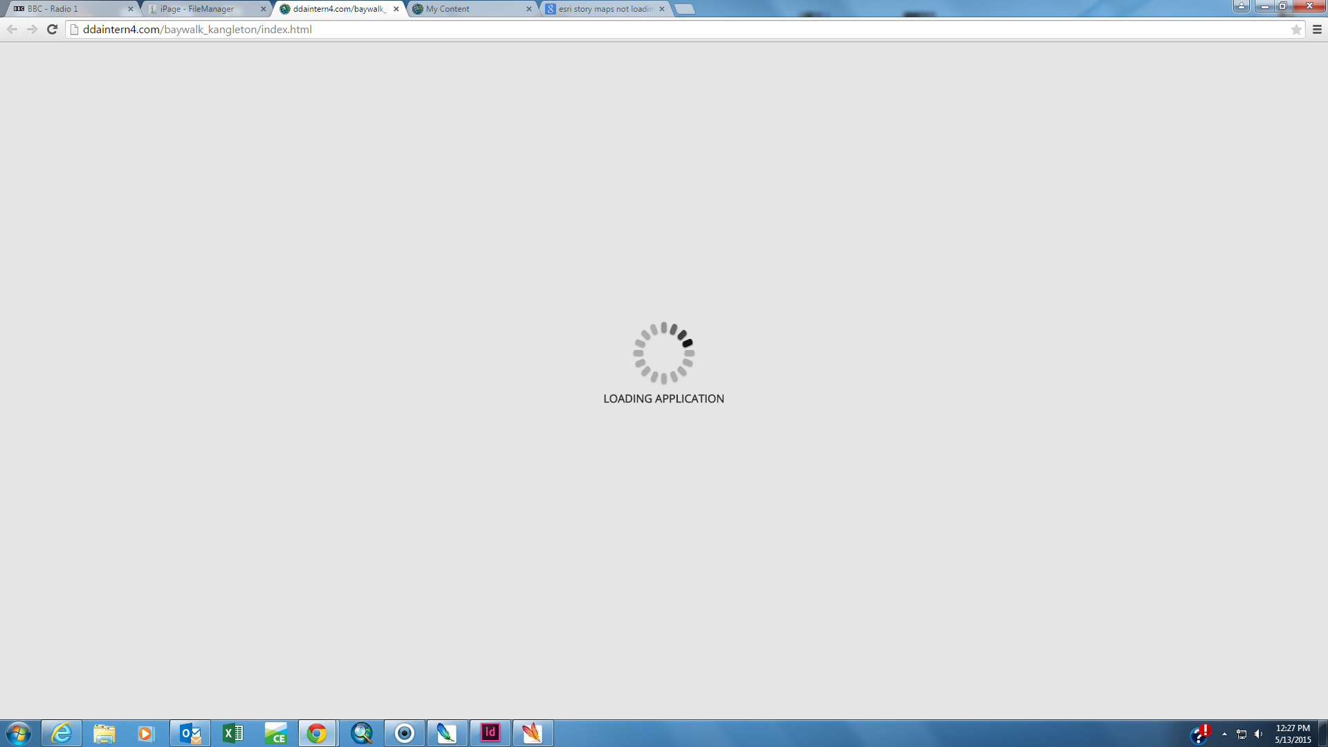

Story Map not loading
7470
17
05-13-2015 09:34 AM
KathrynAngleton
I've made a sequential, place-based narrative story map. I've already made one before, and it displays everything properly. This time, I did the same thing; downloaded the zip file, followed the directions, created my points of interest in the CSV, uploaded it to a publicly shared map on ArcGIS Online, and then uploaded all the files in the zip folder to iPage, my work place's hosting site of choice, and when I try to view it, the loading circle doesn't stop spinning. I've tried re-downloading the codes, icons, everything, to make sure there was nothing corrupted in the folder. I just can't get it to load, and whoever wrote the code didn't use proper indentation, so it's almost impossible to really read through "every line" of code to see what's wrong. Any ideas on what could be preventing this story map from loading?

Now neither of my story maps are working on ipage. Here's the other one. http://ddaintern4.com/k_angleton/index.html
Link to the one from the original post: http://ddaintern4.com/baywalk_kangleton/index.html
GregoryL_Azou
Deactivated User
Sorry again but yes both of those now have the same issue. Maybe you should contact them and ask what they change. The issue is that the following files
http://ddaintern4.com/baywalk_kangleton/resources/font/OpenSans-Regular-webfont.woff
http://ddaintern4.com/k_angleton/resources/font/OpenSans-Regular-webfont.woff
are not returning the expected files.

Something has gone wrong with the first one. You will have to redeploy it from a fresh download of the application source. When I look at the source of the page (right click + view page source), the first one is very different from the second one, the code has been altered. This must be your issue.
KathrynAngleton
Finally got the other one to work, too. Thanks for helping me along the way. I guess the code had gotten corrupted somewhere and I didn't catch it.
